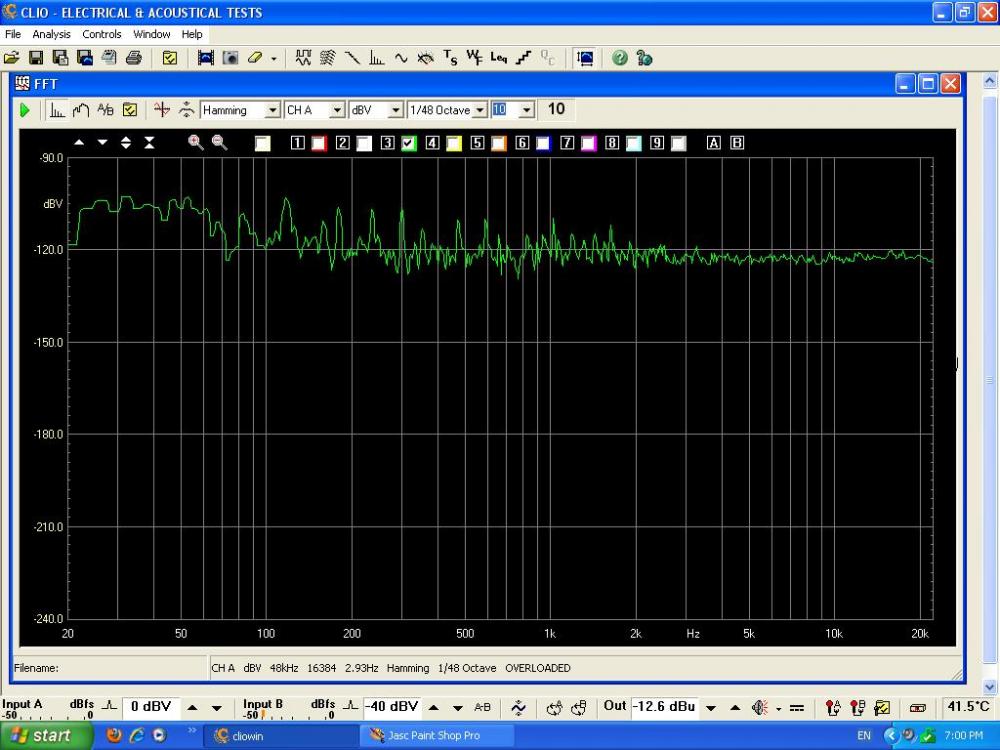

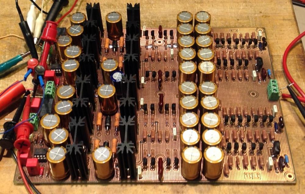

Algar_emi Posted September 18, 2017 Report Posted September 18, 2017 Hi. Just completed my own set of PCB for this amp, see pictures. I also took detailed measurements. Here some measurements: Sensitivity: 1.25Vin max, for 6.9Vac Out Max. into 8 ohms Power: 5.95W into 8 ohms max. BW (Ref 1Khz, 1V): 0.3Hz to 145Khz Noise (gnd input): 0.08mV (Lab. power supply), 2.2mv (Standard Supply), see graph THD (1V, see load): 0.042% (8 ohms), 0.007% (16 ohms), 0.008% (no load), see graph IMD (1V, 1 & 2Khz): 0.007% (16 ohms) In normal use, max volume, gnd inputs, no noise can be hear... You can see the complete files at http://www.diyaudio.com/forums/headphone-systems/109618-krell-ksa5-9.html 2 Quote

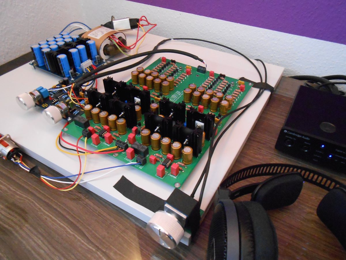

philcrack Posted November 26, 2017 Report Posted November 26, 2017 Hi, i am currently testing with a reduced voltage on the power supply and a little bit more bias. That´s really good. Thanks Kevin! this is my test table: 1 Quote
muskyhuntr Posted November 26, 2017 Report Posted November 26, 2017 I am curious about the board between the amp and power supply. Dual volume controls? Me Quote
philcrack Posted November 26, 2017 Report Posted November 26, 2017 this is a customizable bass mid and high level control with optional pre-amp with jumper up to +4 db at the signal way with the Motorola 33079. A very good preamp. All Sound change components are removed in the signal away everything runs through. I use a very good epcos for the bass adjustment and a very fine old ERO for the tips. here the circuit board. Quote
