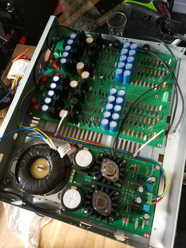

jack Posted March 10, 2017 Report Posted March 10, 2017 I will be using the power supply as in the picture bellow (the PCB arrived today )So happy Sent from my iPad using Tapatalk Quote
jack Posted March 10, 2017 Report Posted March 10, 2017 http://www.antekinc.com/as-0528-50va-28v-transformer/ Earlier in the thread (had you read it) KG said you need ~35V raw dc, so 27 * 1.414 will get you ~38V minus the diode drops for the rectifier(s). I haven't looked at the schematic, but assume a bridge, so -1.4V, so you are at about 32.6V raw DC. Might work. 27-28V transformer will get you closer. 28V Antek above would put you at (28 * 1.414) - 1.4 = 38.2V. It appears some have built this with a 25V transformer. Thank you for explaining. I have read this thread several times, nevertheless it happens to me to ask silly questions as I know less than a little about electronics ;-)Am I correct ?The best would be to have a transformer maid with a voltage between 27 and 28 V so that DC right after the rectifier (bridge) is 35 V. I think this can be done since my toroids are custom made.I have also read in this thread that some pushed PSU voltage higher and changed opamps. Could someone tell me if this is worth it? What are the benefits? I can still return my ops. So why not benefit from a good advise. Sent from my iPad using Tapatalk Quote
