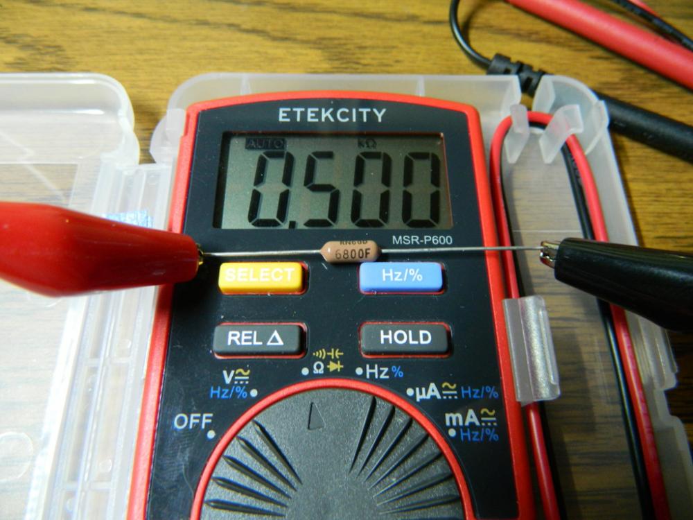

drteming Posted May 30, 2016 Report Posted May 30, 2016 1st post here. Getting ready to go ahead with the build, waiting for the PCB from ebay. I was checking resistors and I found this: I have never come across a Vishay resistor this far off (please no comments on the crappy "multimeter"). Will update once I get the build underway. Thanks KG! Quote
wink Posted May 30, 2016 Report Posted May 30, 2016 (edited) Looks like it's a autoranging meter and probably be better if you could manually set the range to the one lower. That is, if the meter allows you to set the range manually. Cheap meters are sometimes well out of spec when the range is too high. Edited May 30, 2016 by wink more info. Quote
drteming Posted May 30, 2016 Report Posted May 30, 2016 I just had the cheapo meter handy for the picture. I checked it with my Amprobe meter, and it measured 500 ohm. The rest of the pack of resistors (from Mouser) measured between 674 and 680 ohm, perfectly within spec of 1%. Quote
kevin gilmore Posted May 30, 2016 Author Report Posted May 30, 2016 this is why testing the resistors is easier than figuring out why it does not work later. 1 Quote
