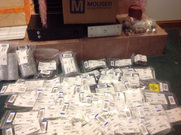

GrindingThud Posted December 14, 2013 Report Posted December 14, 2013 (edited) I've never ordered such a large BOM from Mouser before, what an outstanding company. Perfectly packaged, labeled, and verified: Edited December 14, 2013 by GrindingThud Quote
