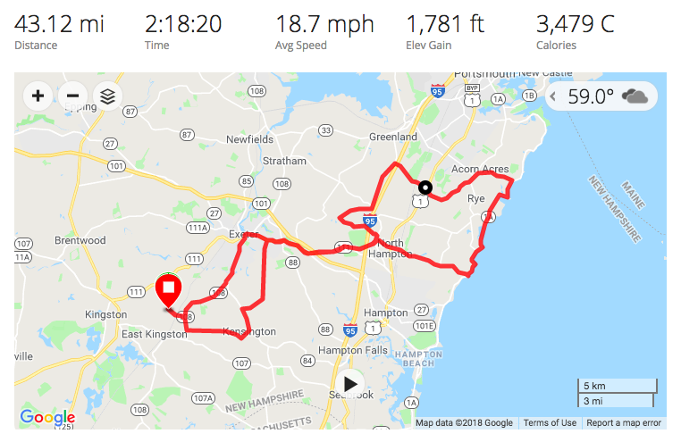

n_maher Posted August 26, 2018 Report Posted August 26, 2018 Got up for some early morning training miles today. 4

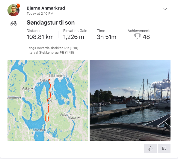

bjarnetv Posted August 26, 2018 Report Posted August 26, 2018 Went on a pretty high intensity ride yesterday, so i had planned to take it easy and just enjoy a short trip in the sun today. Ended up being caught up in the mood, so the trip ended up as a 108km ride... i had forgotten my wallet, and only brought a banana with me, so on the way home i was pretty much running on fumes ? https://www.strava.com/activities/1799130499 2
