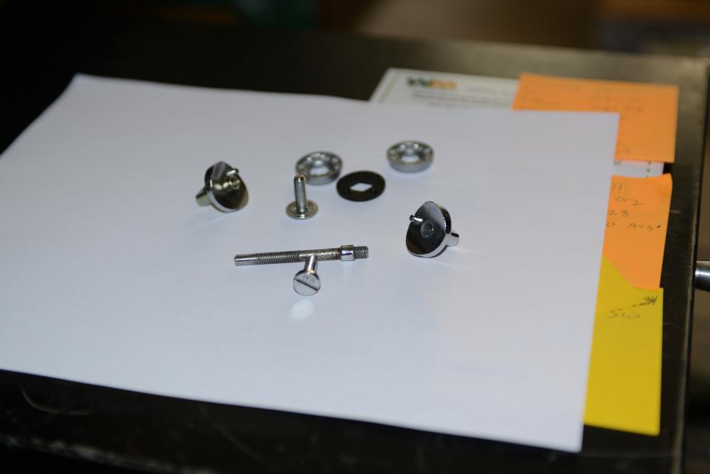

kevin gilmore Posted August 7, 2017 Report Posted August 7, 2017 (edited) anyone know of a place that sells vintage shimano parts, the shifter just cracked off the 24 year old cannondale tube shimano 105sc sl 1056 with bolt thru the tube (or recommendations for a new bike in the $2k to $3k range because anything i'm likely to do is going to be a hack job) Edited August 7, 2017 by kevin gilmore Quote

kevin gilmore Posted August 7, 2017 Report Posted August 7, 2017 (edited) yes please. stupid ass cheap parts 1.75 inch diameter down tube Edited August 7, 2017 by kevin gilmore Quote

kevin gilmore Posted August 7, 2017 Report Posted August 7, 2017 (edited) next time he visits it has to be in the summer, need to put the top down, there are still marks found a generic repair kit that may or may not actually fit the down tube. instructions say to epoxy all parts of it together to the tube, who knows, its a cheap thing Edited August 7, 2017 by kevin gilmore Quote
Pars Posted August 7, 2017 Report Posted August 7, 2017 (edited) Kevin, I found this on bikeforums: http://www.bikeforums.net/classic-vintage/1086619-cannondale-shifter-boss.html http://www.bikeforums.net/classic-vintage-sales/1098978-shimano-group-cheap.html ^ Shimano group, sold, from a cannondale. I could pm the buyer and see if he would part with the shifters or at a minimum the cannondale mounting boss stuff... http://www.bikeforums.net/classic-vintage-sales/1098978-shimano-group-cheap.html http://www.bikeforums.net/bicycle-mechanics/231963-interface-problem-mounting-indexed-dt-shift-lever-cannondale-3-0-a.html http://www.bikeforums.net/classic-vintage/717549-cannondale-downtube-shifter-bosses.html http://vintagecannondale.com/ Is this the replacement you bought? Supposedly according to one or more of the above threads, a Cannondale dealer could get the correct parts. Kozy's is a Cannondale dealer, but it looks like there are a number of them in the Chicago area. Might even have one laying around. http://www.cycle-frames.com/bicycle-frame-tubing/NOVA-LEVER-BOSS-KIT-FOR-AL-FRAME.html Edited August 7, 2017 by Pars Quote
kevin gilmore Posted August 8, 2017 Report Posted August 8, 2017 (edited) that is what I bought, should be here tomorrow, really don't like that you have to epoxy everything together. The cannondale part number is A095 Kit, Shift Boss, 1.75 inch diameter tube, listed as obsolete please pm the seller and see if he will sell just the whole shifter set Edited August 8, 2017 by kevin gilmore Quote
Pars Posted August 8, 2017 Report Posted August 8, 2017 I'll try contacting him tonight. I guess I'm a bit unclear as to what your problem is, and I've never worked on a cannondale before.Is the shifter itself broken or is it just the shifter boss assembly?I would still try calling Kozy's or other dealers as you never know what they might have laying around. Particularly if it is an older mechanic or owner who knows these and knows how to fix them.Sent from my iPhone using Tapatalk Quote
kevin gilmore Posted August 8, 2017 Report Posted August 8, 2017 shifter boss assembly is broken, the threaded rod has the remains of the attachment for the right side. sent an email to kozy, nothing back yet. also ordered thread repair kit with m5 inserts, and 1 meter long 5mm threaded rod. first kind of epoxy pulled out in a minute, trying torr-seal now. the way it worked was that the rod was attached to the one end with thread lock and then the other end, you can tighten down and then the black piece holds it all in place. then the shifters are attached with bolts on each side. Quote

kevin gilmore Posted August 9, 2017 Report Posted August 9, 2017 (edited) the torr seal is holding for now, hopefully the parts coming in are usable. But if you can find someone with the original parts new or used or even broken I will be able to remanufacture with the threaded rod. Very surprised at the idiot that designed this, way too much stress on a 5mm threaded rod with 75th side walls may even switch to brake handle actuators and then recreate the stops for the cables kind of like this idea http://www.ebay.com/itm/MOOSE-RACING-One-Sided-Made-to-Order-37-57mm-Clamp-On-Downtube-Shifters-Adapter/152651747057?_trkparms=aid%3D222007%26algo%3DSIM.MBE%26ao%3D2%26asc%3D41376%26meid%3Dd588e1824d874fb78025ab745f3baefc%26pid%3D100005%26rk%3D3%26rkt%3D3%26sd%3D152651737182&_trksid=p2047675.c100005.m1851 Edited August 9, 2017 by kevin gilmore Quote

Pars Posted August 9, 2017 Report Posted August 9, 2017 The guy on BF got back to me and said I can have the downtube mount, just needs an address. You want to pm me your address and I'll just have him ship them to you. He's leaving tomorrow for the Dairyland Dare, so wouldn't be until next week sometime before he could ship this. As for converting this to more modern indexed using brifters/ergos, you would need to replace the rear wheel, rear derailleur, and the shift/brake levers. Maybe the chain rings or crankset as well. You would need 130mm rear spacing which isn't done easily on an aluminum frame like a Cannondale. Not like steel, which you can cold set. It is only 2mm per side, assuming yours is set up for 6-7 speed (126mm). Sent from my iPhone using Tapatalk Quote
kevin gilmore Posted August 9, 2017 Report Posted August 9, 2017 Pm sent its an 8 speed and I am told the shimono handles are a direct replacement once you deal with the cable stops the down tube is 1.75 inches so other solutions will not work the torr seal seems to be holding for now Quote
