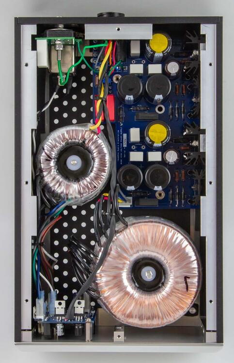

jsts Posted October 4, 2023 Report Share Posted October 4, 2023 Friends, my compliments! Finally, in addition to my SRM-600 with CCS-mod (mr. Gilmore, every time I use the amplifier I mentally thank you!) after years of waiting i purchase a Blue Hawaii SE from a USA owner. Please can you give me hints on how to change the voltage for PSU? Need to change from 117 to 230V (Germany). I'd appreciate it! Quote Link to comment Share on other sites More sharing options...
justin Posted October 4, 2023 Report Share Posted October 4, 2023 (edited) remove the PCB on the power supply front panel there are 2 sets of wire jumpers for each one ,cut the 2 wires that go into pin 3+4 and solder them together The necessary pin connections are written on the board You should also reduce the value of the AC Input fuses by 50% WARNING: Do not attempt any of this unless you are qualified and experienced Edited October 4, 2023 by justin 2 Quote Link to comment Share on other sites More sharing options...
jsts Posted October 4, 2023 Report Share Posted October 4, 2023 Justin, you're amazing! I appreciate your friendly, open and caring attitude! After I get the amp, re-solder the pins in the PSU and verify operation, I will report back. Thank! Quote Link to comment Share on other sites More sharing options...
jsts Posted December 10, 2023 Report Share Posted December 10, 2023 Progress report. I opened the PSU, took out the board: Jumpers before: Jumpers after: When replacing the incoming fuses, I was surprised to find that the 250 volt / 4 amp fuses were installed. I assumed they would be 3.15 amps, so I bought 1.6 amps for my 230V ones. I've put them in for now, although apparently I need to replace them with 250V/2A. Turned the amp on. It works! Quote Link to comment Share on other sites More sharing options...
jsts Posted December 10, 2023 Report Share Posted December 10, 2023 And now the question. I decided to check the balance and offset. Regardless of whether the amplifier has just been turned on or has already been running for 2 hours, the balance between L+/L-, as well as between R+/R-, is always around 0V. When measuring the offset I was confused by the following: 1. After turning on the amplifier for the first time, the L+/GND value was -9V, and the R+/GND value was -11V. 2. As the amplifier warmed up, these values began to increase by about 1 volt over 3 minutes. 3. I left the amplifier to warm up and after 2 hours the L+/GND value was +20V, and the R+/GND value was +20V. Let me remind, that the balance between L+/L-, as well as between R+/R-, is always around 0V. It seemed strange to me that the offset values had such a wide spread and, by analogy with adjusting the STAX amplifiers, I adjusted the offset value to 0V. In short, after 4 hours of operating the amplifier, I achieved that both the balance and offset were around 0V. I connected the headphones and started listening to music and it was, as expected, great (impressions later). I turned off the amplifier and went to bed. In the morning I turned on the amplifier, after 10 seconds it SUDDENLY turned off. I realized that these are input fuses. And so it was - they burned. I replaced the fuses with new ones (back to 250V/1.6A for now) and the amplifier turned on successfully. I decided to check the offset again and found that L+/GND was -38V and R+/GND was -39V. After about an hour and a half, the values reached 0V. Actually, the question is: what should the offset value be when the amplifier is not warmed up and when it is warmed up? Quote Link to comment Share on other sites More sharing options...
justin Posted December 12, 2023 Report Share Posted December 12, 2023 the reasoning was to set the adjusted value slightly high, rather than slightly low, due to ice cold power ups in the winter just minutes after it comes off the UPS truck 1 Quote Link to comment Share on other sites More sharing options...
jsts Posted December 12, 2023 Report Share Posted December 12, 2023 Justin, hello and thank you! I understood. So the "run-up" is 43V. So now, basically, if after turning on the amplifier the offset is -43V, after 3 minutes — -28V, after 30 minutes — -15V, after 60 minutes — -5V, and after 90 minutes — 0V, there's no need to worry about it? Or would you recommend to adjust it so that the offset is, for example, -35V when power is applied, and +8V when it is fully warmed up? I'm not talking about sound quality. I am talking about observing the correct parameters that you have determined by your engineering thought. Quote Link to comment Share on other sites More sharing options...
jsts Posted December 16, 2023 Report Share Posted December 16, 2023 And one more quick question. After warming up, the amplifier begins to make noise. The noise is not loud. But clearly distinguishable, in the form of a continuous hissing/rustling sound. It's like water running through the pipes. I tried to cover the amp with a towel and found that the source of the rustling was to the right of the far right tube (as viewed from the front), towards the rear panel, near (but not beside) the RCA1 inputs. According to the photos, it could be a film capacitor (red)? Or something that looks yellow? I haven't opened the chassis yet, but I plan to figure it out myself and eliminate the annoying noise. The parcel with the amp went from USA to Germany something could be loose.... So, what to look out for? Quote Link to comment Share on other sites More sharing options...
