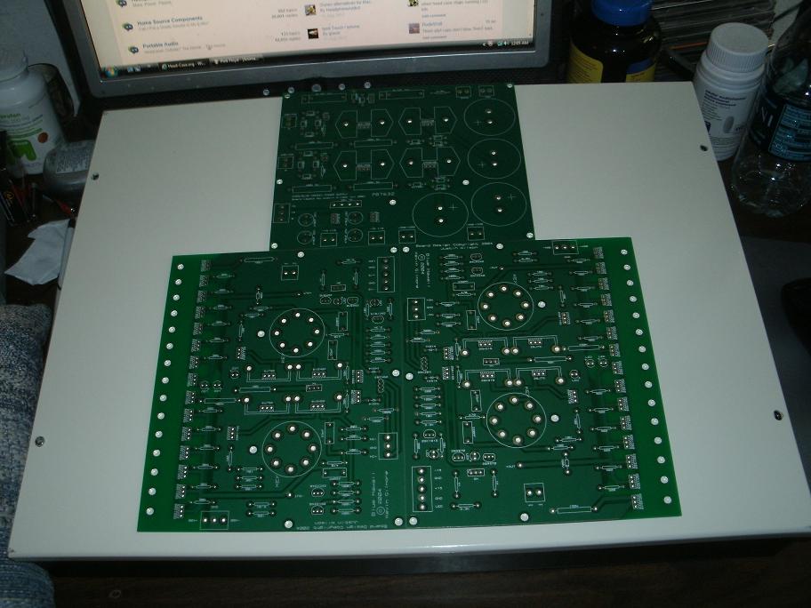

livewire Posted August 21, 2012 Author Report Posted August 21, 2012 Before anyone asks - those are pain killers on the left, vitamins on the right. Below is a pic of the rough layout. The boards will have a gap between them, the left amp pcb shifted back so the overall tube footprint forms a rectangle. The psu pcb will be stood off higher than the amp boards with about a half inch of overlap above the amp boards. Still waiting on the heatsink delivery. The new soldering station showed up on the doorstep yesterday along with a lighted gooseneck magnifying glass. Started stuffing boards with resistors last night. Now it's time to find the ideal soldering temp, then go to town with Mr Kester. Quote

livewire Posted September 25, 2012 Author Report Posted September 25, 2012 (edited) So, it's been a month since I posted on my necrofied thread. Amp and PSU boards are stuffed, undergoing soldering. The populated CCS boards are now mounted on the heatsinks, the chassis top-plate has been drilled swiss cheese style. The bottom "drawer" has the trafos mounted along with the input & output jacks and IEC module. Still waiting for my 50K Alpha Quad to arrive.... I'll post pics soon when I find my camera. My daughters have a nasty habit of borrowing it and not bringing it back. Hmmm? Edited September 25, 2012 by livewire Quote
