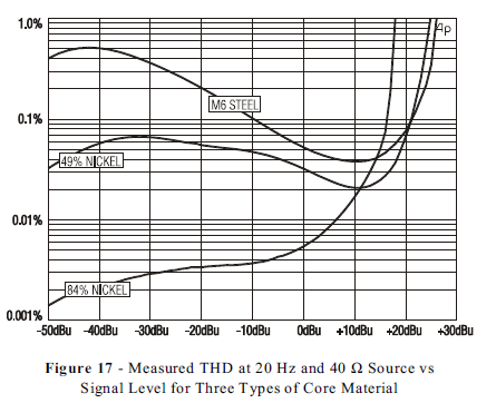

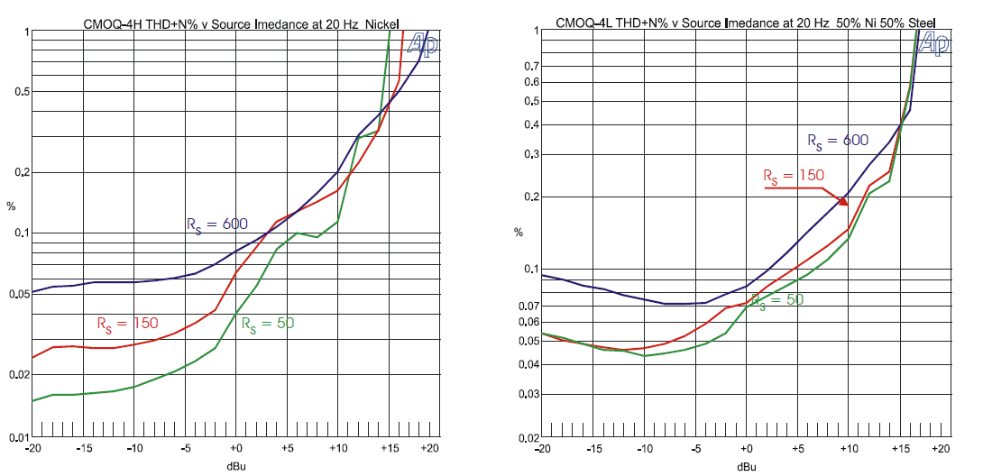

dsavitsk Posted December 11, 2014 Report Posted December 11, 2014 sceptical i must admit but i want to believe. what are you measuring to verify the difference in sound that you're hearing? I know the audio world is full of nonsense, but this is not one of those places. Above is a basic comparison of various cores. This is a comparison of the same Cinemag transformers, one with hi nickel core, the other with pinstriped nickel and M6 steel. What you should notice is that for both, at low signal levels, the nickel has considerably lower distortion. However, as the signal level increases and the core reaches saturation, the steel becomes better. This is why nickel generally makes less sense in a single ended transformer where the DC leads to early saturation -- basically, by the time the core is large enough to accommodate the DC, it is so big that its permeability is reduced to the level of steel. But in an application with little to no DC, the better core can be utilized. Much more is available in Chapter 11 of The Handbook for Sound Engineers, Third Edition by Bill Whitlock. Available from http://www.jensen-transformers.com/application-notes/

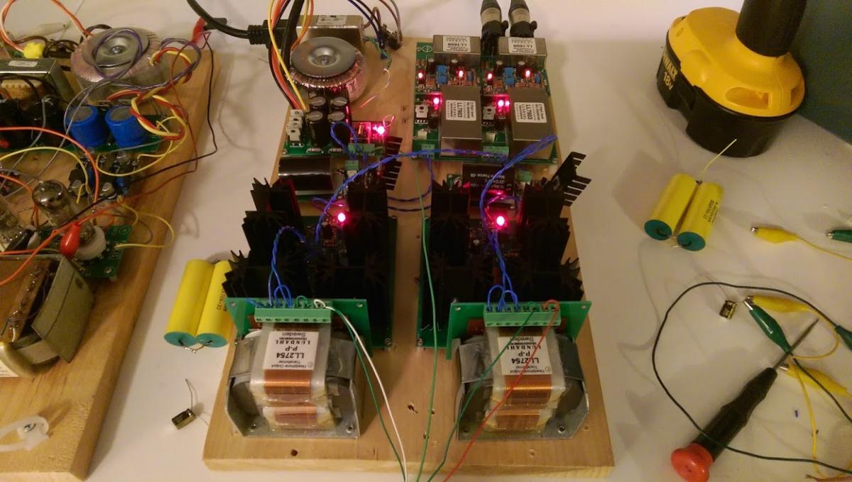

dsavitsk Posted December 11, 2014 Report Posted December 11, 2014 I think he's using these transformers as gain elements so they're right in the heart of the signal path In this particular case, I am using amorphous cobalt input transformers, mu metal gain transformers, and amorphous steel outputs. 2
PretentiousFood Posted December 11, 2014 Report Posted December 11, 2014 My, what big cores you've got!
kevin gilmore Posted December 11, 2014 Report Posted December 11, 2014 you do know that the wood is conductive... you need a ground wire for the wood. (no kidding, granite audio puts a ground wire on their faux granite case)
nopants Posted December 11, 2014 Report Posted December 11, 2014 In this particular case, I am using amorphous cobalt input transformers, mu metal gain transformers, and amorphous steel outputs. IMAG0296.jpg Interesting ideas, a shame I've only some K401s as my dynamic headphones.
tin ear Posted December 12, 2014 Report Posted December 12, 2014 I know the audio world is full of nonsense, but this is not one of those places.core_comparison2.png Above is a basic comparison of various cores. core_comparison.png This is a comparison of the same Cinemag transformers, one with hi nickel core, the other with pinstriped nickel and M6 steel. What you should notice is that for both, at low signal levels, the nickel has considerably lower distortion. However, as the signal level increases and the core reaches saturation, the steel becomes better. This is why nickel generally makes less sense in a single ended transformer where the DC leads to early saturation -- basically, by the time the core is large enough to accommodate the DC, it is so big that its permeability is reduced to the level of steel. But in an application with little to no DC, the better core can be utilized. Much more is available in Chapter 11 of The Handbook for Sound Engineers, Third Edition by Bill Whitlock. Available from http://www.jensen-transformers.com/application-notes/ interesting. thanks for that.
