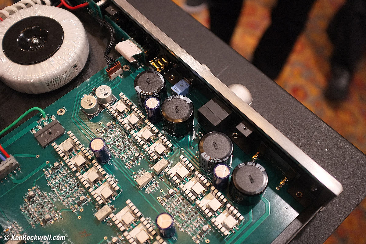

n_maher Posted February 29, 2012 Report Share Posted February 29, 2012 5 on a balanced amp seems insanely high to me, and I don't listen at churchmouse levels like you do Nate. If we're going on the assumption that 5 equates to an effective 10 given the balanced configuration then I revise my previous statement, having the low gain option set that high is unlikely to yield good results. I'm also not a fan of parking the outputs right next ot the power transformer. Where's the logic in that? Quote Link to comment Share on other sites More sharing options...

spritzer Posted February 29, 2012 Report Share Posted February 29, 2012 Is is me or does that look like a 2-gang Noble AP-25? http://www.kenrockwell.com/tech/ces/2012/images/Bryston-innards-DSCF6579-1200.jpg How are they doing a fully balanced amp with only two gangs and a dual gang balance pot? Hmmm.... Quote Link to comment Share on other sites More sharing options...
