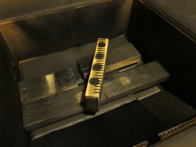

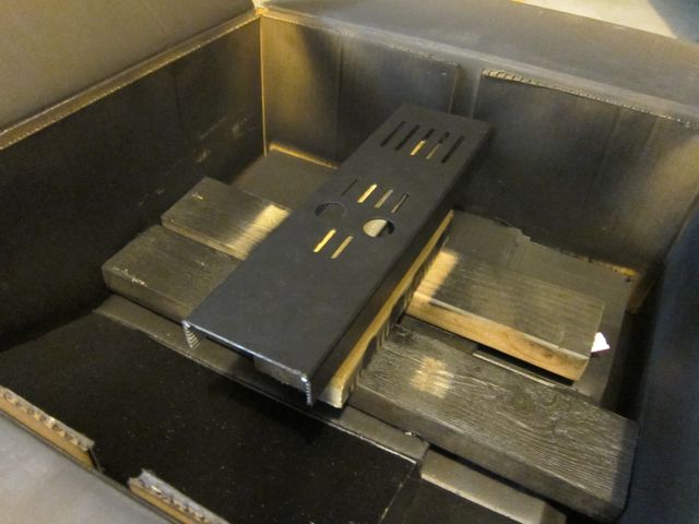

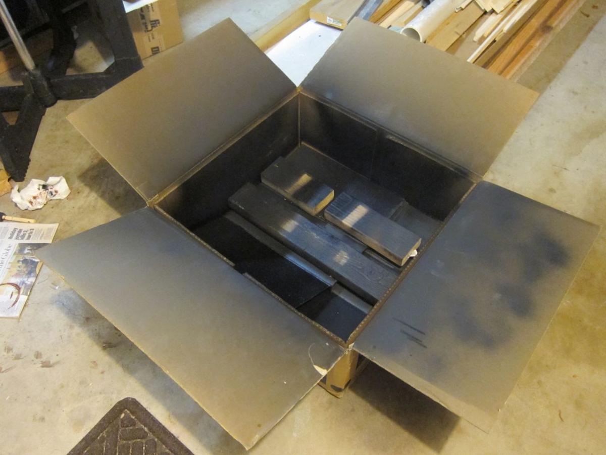

jdkJake Posted January 5, 2012 Report Posted January 5, 2012 Ouch, bad karma dude. What did you feed the ducks? Seriously, the advice given by swt61 is good. The rules of 100 will serve you well. Start with 120 grade sandpaper followed by 220, and finish with 320 til it is smooth and clean. The chemical stripper will work as well, but, be advised, the stuff can be more trouble than it is worth. It all depends upon how thick the paint is and how long it has been allowed to dry/cure. Be sure to use in a well ventilated place. Nasty fumes. My advice to you in the future is to fashion a paint chamber. You put the part to be painted in the chamber, apply a coat and then close it up quick. Cover it with towels until the next coat. Cheap, works well and scales even better. A couple of pics are attached of what I used for my last several projects (both amp related and not so much). It scales well for even larger material, just get a bigger box! Hope this helps. BTW, friendly advice, stop feeding the ducks, nothing good will come of it. We learned that the hard way in our neighborhood.

jdkJake Posted January 6, 2012 Report Posted January 6, 2012 So, I would avoid the string/hanging concept if possible. Far too much potential for movement. You want a solid, firm foundation for the part to be painted. The goal will be to elevate the piece high enough to get a clean shot with the spray can, yet, still allow you to close the box to minimize the effects of random dust. Since I have the lid off anyway, the pics enclosed below are a simulation of what I mean. In this way, you have complete access to the piece to be painted while not allowing any one edge to be obscured or obstructed from a clean shot. I have to assume, since you went to Home Depot for supplies that you are using Rustoleum spray. My weapon of choice. With that paint, you can apply a light coat and re-coat in about 30 to 45 minutes with another coat. Don't go too much longer, otherwise, wait a day (or at least overnight) and lightly (and I mean lightly) sand and spay another coat. This is always your fall back position. Let it dry, lightly sand with no less than 220 (320 might be better) and re-coat until the texture and depth of color is what you are looking for. This is true regardless of color. This is the beauty of DIY, just take your time and do it as many times as it takes until you are happy with the results. You cannot rush paint. It takes as long as it takes. If you mess up or or are unhappy with the results, sand/strip it off and start again. Good luck to you! Looking forward to the end the results.

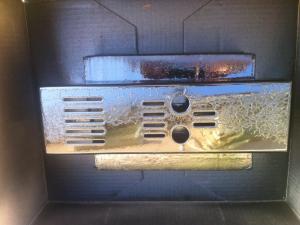

crappyjones123 Posted January 13, 2012 Author Report Posted January 13, 2012 (edited) so this happened today after I put on the last coat ...wtf? Edited January 13, 2012 by crappyjones123
