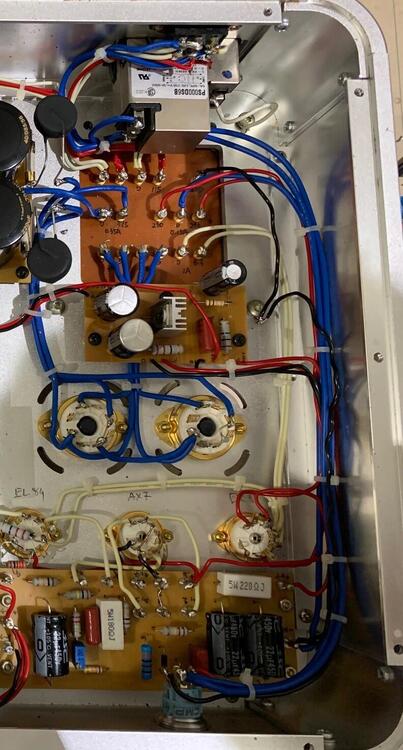

I believe this is the chassis used: 4308 rounded corners Full aluminum DAC chassis tubpower amplifier enclosure box | eBay I believe Kevin has also managed to salvage the following parts from the original build: 1. Aluminum knob (1pcs 50x27mm Gold Aluminum audio Knob Volume Control potentiometer | eBay) 2. Strip of unknown wood 3. Power switch 4. IEC inlet 5. 4x feet The total salvageable value of the parts was certainly under $150. The cheap Chinese tubes included were certainly worth under $100. Hence, the total as-delivered value of Thuan's amp was roughly -$8,600 CAD, or about -$6,000 USD at the time, -$5,000 USD for the amp itself, plus the cost of shipping, currency exchange, and a customs nightmare. Pretending that Kevin or anyone else would actually be crazy enough to charge a modest $150 an hour for their time to work through to completion on completely re-designing and re-building something so hellishly nightmarish, the cost of the estimated 50 hour repair and parts would come to: $9000 USD. Adding this to the acquisition cost would bring the total repaired cost to $15,000 USD. I doubt anyone else could actually be both qualified and convinced to work on it in the first place. -
orientexpedite replied to kevin gilmore's topic in Do It Yourself
Adding to my embarrassment and frustration, these things were priced and even named similarly to Mikhail's Singlepower ES-1 and ES-2 stuff. This "Reference Megatron" (turns out not a Megatron at all) is stamped the "ESHA-2", and shares a chassis with the FLS Audio "ESHA-1", Tran's "845 DHT SET" amp, paraded around in his "custom would transformer" workshop on SBAF : 845 DHT SET electrostatic headphone amp | Super Best Audio Friends The first local head-case member to look at the amp (it was just returned yesterday) measured the "custom transformers"... they indeed are shot and need to be replaced, and it was two years before the amp blew up. Since my "Reference Megatron" fls.audio amp listed for 5.5K USD (and came out closer to 6K USD with the shipping nightmare from Vietnam), how long before all the other non-reference amplifiers sold under fls.audio on ebay blow up? Paramesh's amp lasted 15 minutes.... -

I agree: there are multiple implementation issues. The power supply schematic likely existed on a napkin at one point, but Thuan doesn't have it. In two years, I've never seen a copy, in spite of repeated requests. Upsizing the caps to 550V 220uf slowed the issue down, but didn't eliminate it. In two years, when the amp worked, it was excellent, which was usually for bouts of moderate length, until the mains transformer finally gave out. However, any excellence could likely be attributed to the vintage tubes stuck in the amp by myself. This Thuan fellow's immediate and selfish PM response today, after two years of providing no support for an amp he asked 5.5K USD plus shipping for, has raised my ire. Curious and telling, too, is the nearly simultaneous appearance of an apparent shill, as above. I actually have no hard feelings, overall - this community has been fantastic to me, I've rolled more vintage tubes than I ever thought possible, and I've been the recipient of a great deal of kindness and outright generosity from tube collectors, fellow enthusiasts, and so on. Everything from NOS pinched waist Philips E180CC's, to several quads of iconic gold pin USA 7308's and Holland 6922 from the early 60's, were practically gifted to me by a kind-hearted Canadian collector for my T2 build; this community has been stellar. A fellow with two Shangri-La SR's sent me one pair from Korea for roughly half the Canadian cost of a new pair. GeorgeP is a kind-hearted and generous builder, as you well know. It's too bad that I wasn't aware of George and these threads a couple of years ago. I'm sending a hi-res picture of the innards to Birgir, who has also been very helpful over the years. If he or anyone else wants, I am happy to get Thuan's unique "Megatron" masterpiece to them. Thanks for being so kind as to reply. Thanks for all of your help and suggestions. -

You know, not many things upset me too much, which is why I suppose I've put up with this amp for 2 years; however, the IMMEDIATE and IDENTICAL reply I received from Thuan BOTH here on head-case (thuytn) AND on head-fi (tranhieu) to the above post does get under my skin: I've just seen your post on HC. Could you please remove my name from that post? It could heavily affect my future sales. Hopefully you could understand my situation. Cheers Thuan Wow, this fellow has guts. Hence, I will provide some helpful, clarifying details: 1. Thuan's amp was dead the week it arrived. It had eaten through it's first set of 6 under-sized 220uf 450V Nichicon power filtering caps, and blown the soldered fuses between the GZ34 rectifiers and the caps. The inrush current was virtually uncontrolled on startup. 2. Thuan provided ZERO support, and was completely unresponsive. 3. Thuan was using a different account for amp/T2 board and transistor sales on head-fi (kytuphicanh), which was scrubbed by head-fi moderators, who added the warning: Caution: Incomplete Sales Why? Good question. The next fortunate head-fi member to buy one of Thuan's Stax Megatrons was paramesh; Paramesh contacted me directly regarding my Megatron build, and we basically had the same experience: amp dead within a week, zero support or accountability. I have all the PM's. Hence, the head-fi moderators deleted Thuan's account, kytuphicanh. No worries, Thuan has several other accounts, (including thuytn, tranhieu, fls.audio on SBAF and tee8tee4388 on reddit, among many others, no doubt) 4. Thuan's Megatron contains no delayed-start or soft-start circuit of any kind, not even a thermistor for crying out loud. The power filtering caps blew repeatedly. 5. For additional clarity, please see pictures attached of Thuan's caps upon arrival, and within a WEEK of use. Notice any tops blown right off? This happened 4-5 times before a thermistor was installed, and then the power transformer died... 6. The main power transformer was described as (pictures of his winding rig are on SBAF): "Custom-wound Kawasaki 0.23mm Z9 core transformers". In reality, the mains power transformer is under-sized and is now dead. 7. Anyone on head-case who would like to further evaluate the quality of this fls.audio Felitsa Audio amp build is welcome to receive it at my expense via UPS Express, worldwide. It is a large, single-chassis build, and it is quite dead, yet again. Cheers, indeed! -
Hi All! I have had the fortune of having owned one of Tran's (Thuan, Thuy etc...) Megatron builds, shipped from Vietnam, for the past two years... I bought it from the same Head-fi account that was selling T2 boards and kits since 2005: kytuphicanh (now using tranhieu on head-fi and fls.audio on ebay). It was a fairly temperamental build at the outset, eating through the power supply filtering caps... until I eventually upgraded them to Kemet ALC10 550V (from Nichicon 450V) and added a couple of MS-22 thermistors to slow the startup. However, the amp recently began eating the 5A inlet fuse, and I suspect that either the primary or secondary filament transformer has given up the ghost. Would someone in North America be interested in taking a look, without obligation? If you can't fix it, you can simply bin it. It seems like a waste to bin it without at least giving it a second chance. It was a fine sounding amplifier when it was working. I would be happy to UPS the amp to you. I have some very nice tubes you may be interested in for your trouble, I'm under the same handle on Canuck Audio Mart. I have a DIY T2 coming from GeorgeP, so I'm not in a terrible rush or anything like that. Thank you!
