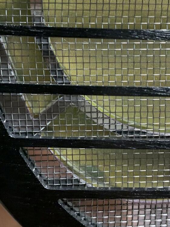

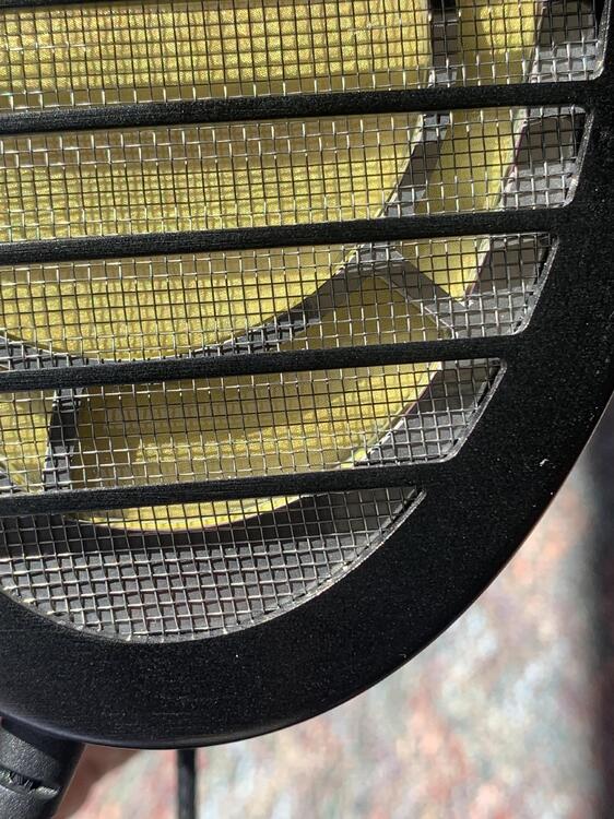

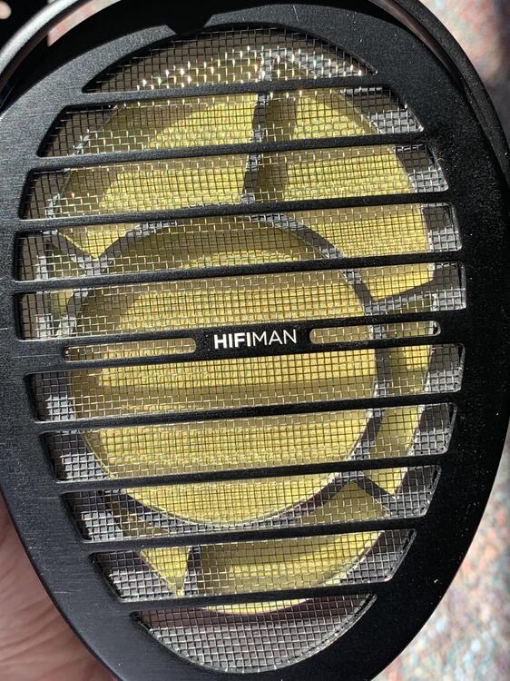

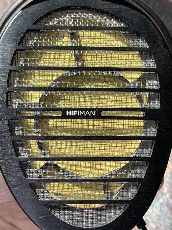

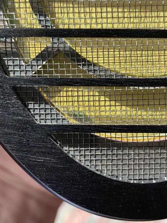

There will be plenty of demand for DIY repairs; this is what my second set of Shangri La drivers looked like after just over two years. You will be one busy man. The first set had a rattle in the right driver and was replaced, also. Build dates were 2018, 2019, 2022. The last Hifiman warranty replacement took 6 months to arrive. Traded the new set for what I paid for them - a little more than a moldy bread sandwich. At least the Hifiman sandwich comes with a 5 year warranty.
