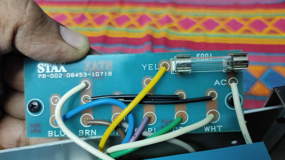

The recent visitors block is disabled and is not being shown to other users.

  1. Mission accomplished!!! Pics for your viewing pleasure. Job may not be neat but serves the purpose really well. 🙂 Album - Rewiring to 240V step wise Many thanks to @spritzer and special mention to @Mach3!!!
  2. Hi, @Mach3 @spritzer. Exactly the same issue with me. Purple and Blue wires are not connected to transformer windings. What are the next steps? Please share them over pm. Is it even possible. Thanks again for the support this awesome forum is extending.

  5. Thank you so much Birgir for a fast response! The wiring changes suggested are for 230 or 240v? I have verified that both blue and gray wires go inside the transformer. Blue and Gray wires
