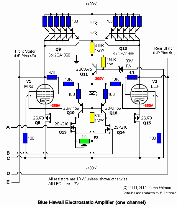

  7. my tube filament 6.3VAC supply was grounded with two resistors, (but too low of a resistance, only about 150ohms each) I did this to create a virtual center tap to avoid some annoying tube buzz I was getting from the beginning, it solved the buzz but I guess this added circuit also created a voltage potential that exceeded the el34 cathode to filament maximum voltage ratings and would time to time short circuit v- to gnd (arc in the tube) and pulled too much current in those moments that fried one of the KSA1220A transistors randomly. thank God I had fuses between my amp and DC power supply which probably saved my power supply every time. so with all this in mind, you got to wire the Filament correctly as Kevin has pointed out to avoid creating such a potential in the tubes.
  8. Hello, I build the DIY Blue hawaii some months ago, and everything seems done according to the "book". but I have got a big problem. every now and then a KSA1220a Transistor goes bad randomly mostly at start ups but sometimes even in the middle of listening sessions. The KSA1220a transistor replaced the 2SJ79 from the older schematic (under the tube). I have tried different tubes, also transistors from different sellers. the problem remains! it works a few weeks than one transistor dies randomly. Has anyone experienced such a problem and know what the problem could be and how to solve it? its so annoying.
