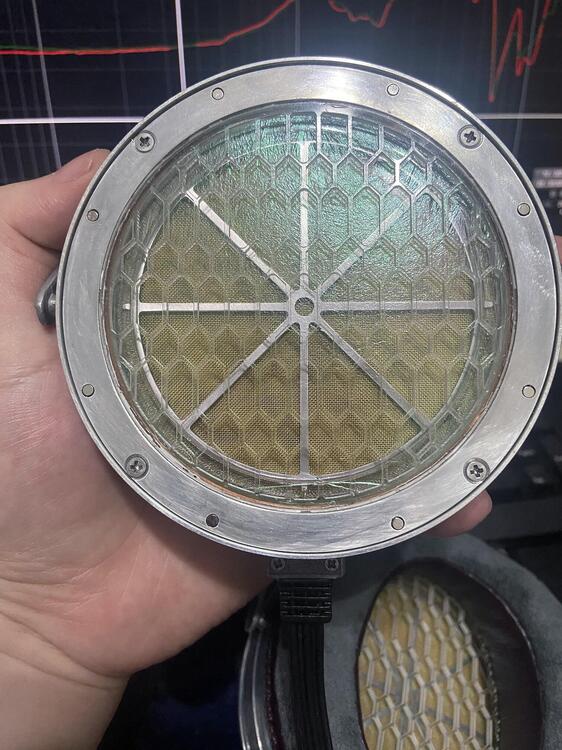

  4. They are a notorious chinese workshop specializing in the production and sale of counterfeit headphones. There are now many workshops in China specialize in producing counterfeit headphones, with zmf, abyss, beyer, and sennheiser being the most affected.
  5. Kabeer started following Kung
  6. From an engineering perspective, hfm and stax differ in design in many aspects, the mesh stator alone cannot be used as a simple evaluation criterion. I would like to briefly discuss the following points: 1. Different Assembly Structures. Hfm uses glue to bond both spacers and stators, unlike stax driver house. Their assembly method also borrows from early Sennheiser and Sony design concepts, attempting to isolate the shell and driver vibrations through flexible coupling. In other words, if you disassemble any non-latest hfm headphone, you can see the driver is sandwiched between the EVA foam and panel on both sides. These three headphone assembly methods—"stax(driver house + rigid shell)," "senheiser、hfm(flexible coupling assembly)," and "completely ignoring vibration transmission"— will produce some differences in subjective listening, but these differences are not significant in the frequency response curve. 2. Different stator acoustic designs. Stax stator acoustic surface size is consistently significantly smaller than the diaphragm size. This design improves sensitivity a bit and also provides a gradient radial damping for the diaphragm. Limiting the acoustic surface size at the stator level is also one of the reasons why stax have a bit different image compared to other estats. 3. Different mesh counts. Stax uses lower mesh counts, such as 60-80 mesh in the Omega and x9000, while hfm uses higher mesh counts, around 300 mesh in the Shang JR/SR. Lower mesh counts result in more transparent sound waves, while higher mesh counts provide more uniform but higher damping, leading to audible differences in subjective listening, but there are no winners in this regard. 4. Different earpad and wearing design. This goes without saying, it greatly affects the sound of electrostatic headphones, and hfm and stax have almost opposite design philosophies. 5. Different diaphragm. Whether it's the thin film material itself(pet vs pps), the conductive coating, or tension, hfm and stax are all different.

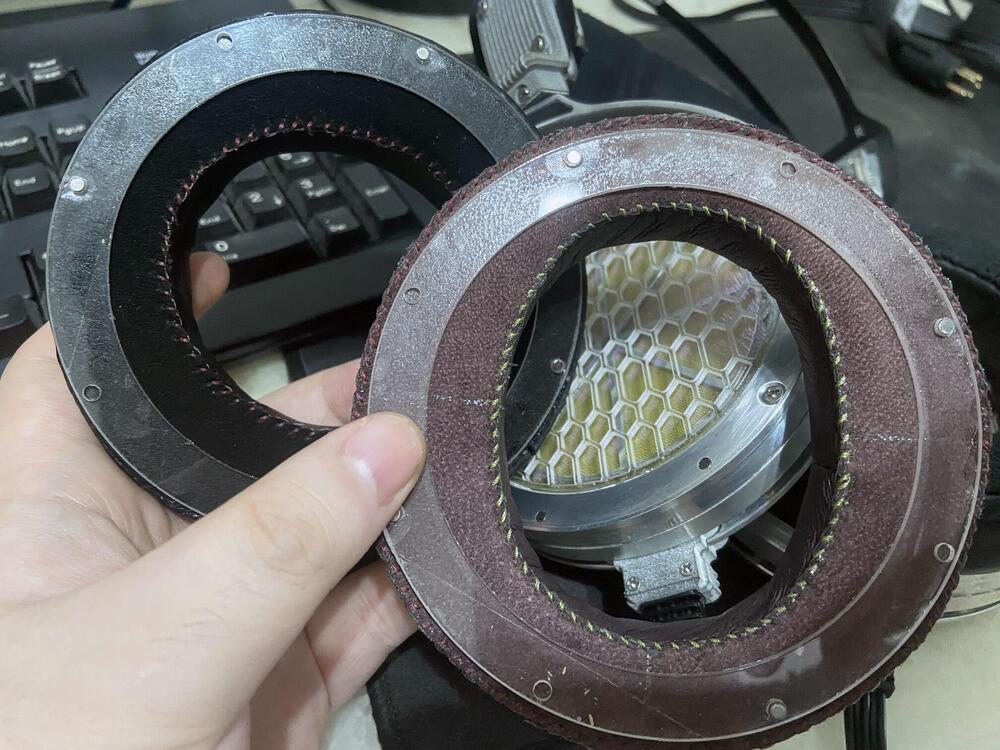

  8. Try an ATO alcohol solution with a concentration below 10% and add 1-2% volume of AEO7. This is the conductive coating I use now. It can make a transparent coating with a stable surface resistance of 10^8Ω
  9. They thought of the human head as a flat test fixture...ignoring the fact that the head is an ellipsoid with a small curvature at the front and a larger curvature at the back. I can only say that I just overestimated Stax's design capabilities in the past.

  11. Many audiophiles in China can't stand the warm bass and dark tone of OG 007, then some people replace the OG 007 earpads with kennerton thror earpads to make 007 sound more transparent and neutral. The Japanese official website says that 007s earpads are sound absorbing, which improves quietness and refine the sound...It also looks like a reverse operation for current stax tuning but stax did it themselves, this makes thror 007 VS 007s very interesting... And according to my experience in making earpads, the use of different cloth on the inside of the earpads will warm the tone, although to different extents, so I'm also curious, if 009/009s are replaced with 007s earpads, will it alleviate some wonky or bright problems and make the sound more natural.
