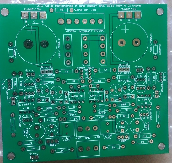

  7. I have two of these in my drawer, is that a bit crazy? RBV5006, max RMS voltage 600V, max average forward current 50A (but these are old, datasheet says production begins in 1998). The bridge in the BOM is 100V/4A http://www.allcomponents.ru/synsemi/rbv5006.htm http://www.datasheetcatalog.com/datasheets_pdf/R/B/V/5/RBV5006.shtml
  8. The BOM of GRLV. You've mentioned its BOM (the Excel BOM) in the GRLV thread for a few times, but I still haven't find it. I got the gerb file (zip) and the schematics (pdf), unfortunately both of them haven't have the standard/stock bridge model that we should look into.
  9. the first step is always the most difficult. although you could laugh at, man... after frying a bunch of amps, I think I will get a working one.
  10. I don't know, I usually use gerbview, works fine with zip files. Does zofzpcb support zip files? edit: zofz finally works after multi-trying. edit2: Zofz only works twice on my old-granny-level-pc. gerbview and gerberlogix work normally on my this old computer. That Zofz stuff is cool! I havta save some dough to buy a lastest Intel-i3-platform first!! Or even Zen!! edit3: zofz is indeed amazing! sometimes it works alth under cpu load 99% (envy you guys' decent computers)
  11. oh, sorry. should be digits... where to find to the BOM? I've only got the gerb file...
  12. @Pars Hi Pars, as for the bridges on GR LV, what kinds of bridges are needed? Do some of them measure better? (on the 6.5 bits stuff or even 8.5 bits)
  13. Hello, how to use this software to view Kevin's zip gerb files?
  14. Update: suddenly I found a 2 x 18 VAC transformer in my house (which came from a power amp), so I don't need to buy it. fisrtly I need the 13.5 VDC, so I just change the R8 and R9, then everything is fine? (R7 = R10 = 1.5k, plus the 10V version LT1021-10, 9.1V zeners) R8 = R9 13.5 x 150 -1500 = R8 = 525 (R8 + R7) / R7 x 10 = 13.5 If using the 7V version (R8 + R7) / R7 x 7 = 13.5 (R8 + R7) / R7 = 1.9286... We change R7 to 2k to make it simpler R8 = 1858 approximately PS, good to hear this PSU running fine at 15V
