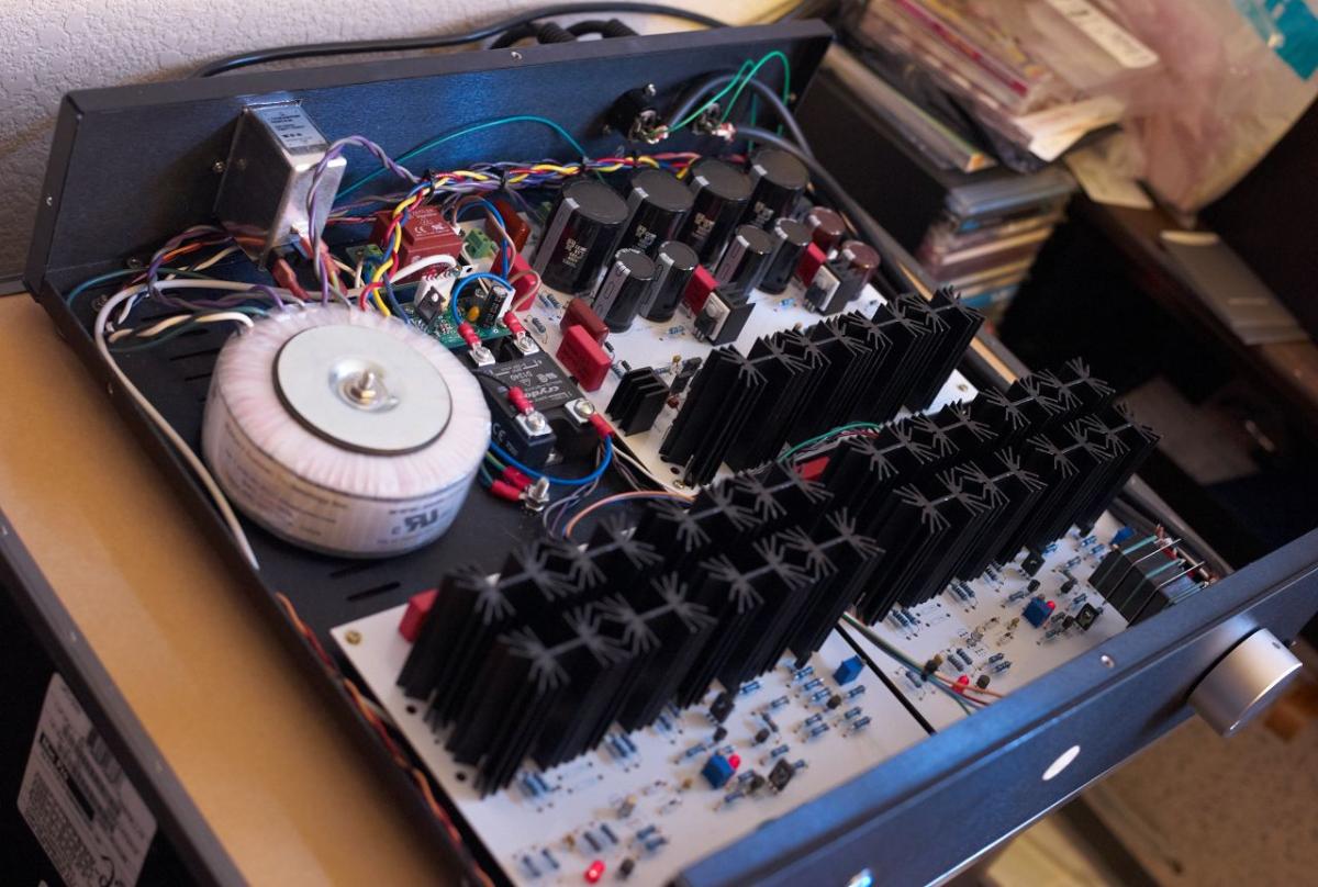

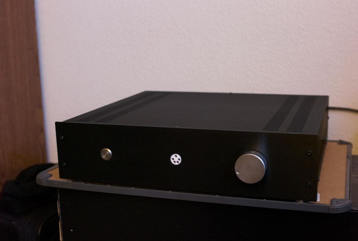

  7. Thanks again for all the positive feedback. The black one was custom 20 series 18"x16" from Par Metal. The gold ones were PRAL-1hc from THL Audio.

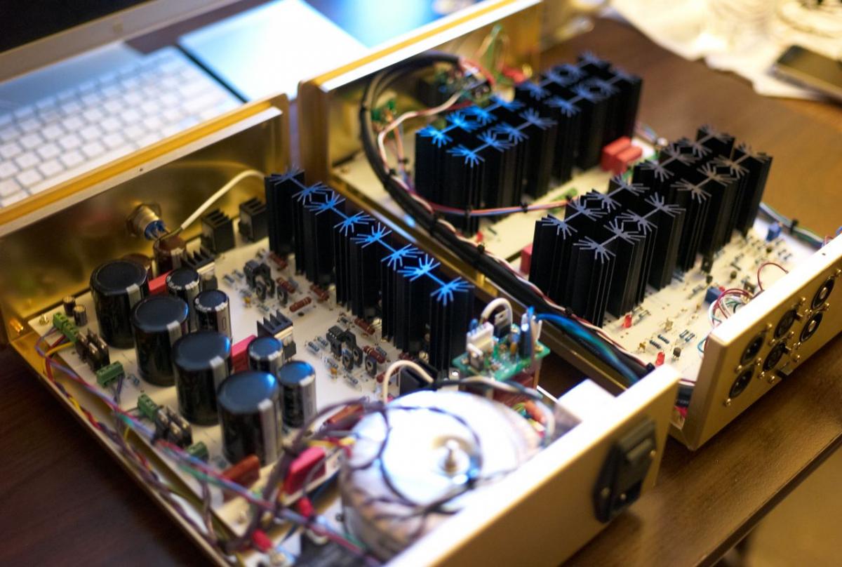

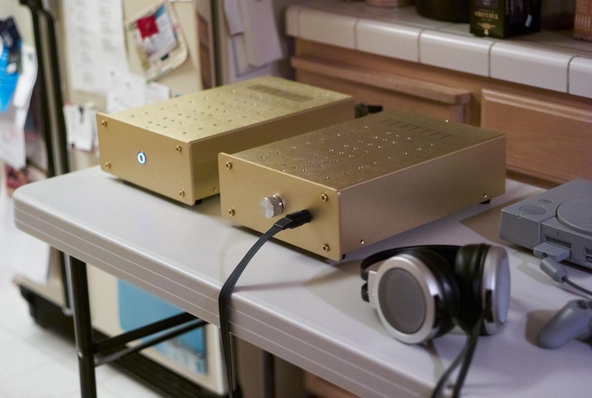

  9. After following this thread for almost two years, I have finally finished building 2x KGSSHV amps that I have been working on since April 2012. As these two amps are my first foray into DIY electronics, I can attest that all the information from this thread (as well as from the T2 thread) were sufficient in resolving all my questions/issues that I had along the way. Due to excessive foreign travel, I was only able to work on these amps sporadically (and only when not jetlagged!). The first one (single box unit) was completed using the IXY current source. Unfortunately, the second unit was delayed after I found out that Par Metal had burned down. I finally got around to sourcing the cases and finally finished the second unit (A1968) a few days ago. I want to thank Kevin Gilmore for the awesome design and the members here on the wealth of information shared!
