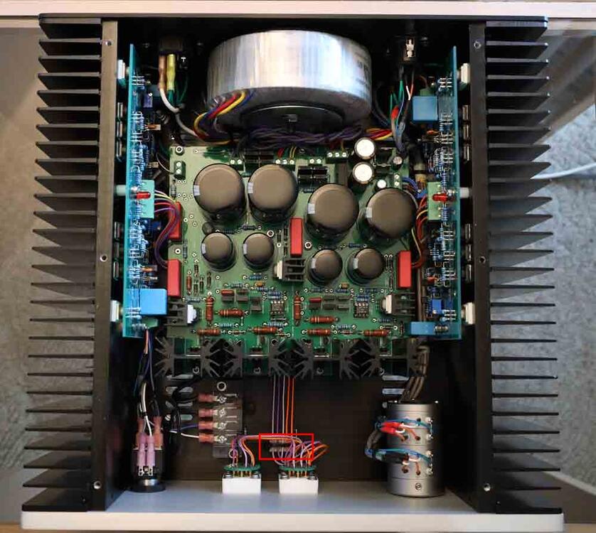

  10. Working on a CFP3 for Todd, and had a question as to why a couple of caps aren't populated. This has switching for SS or ZF implemented. It's consistent in all 4 locations on the 2 boards.
