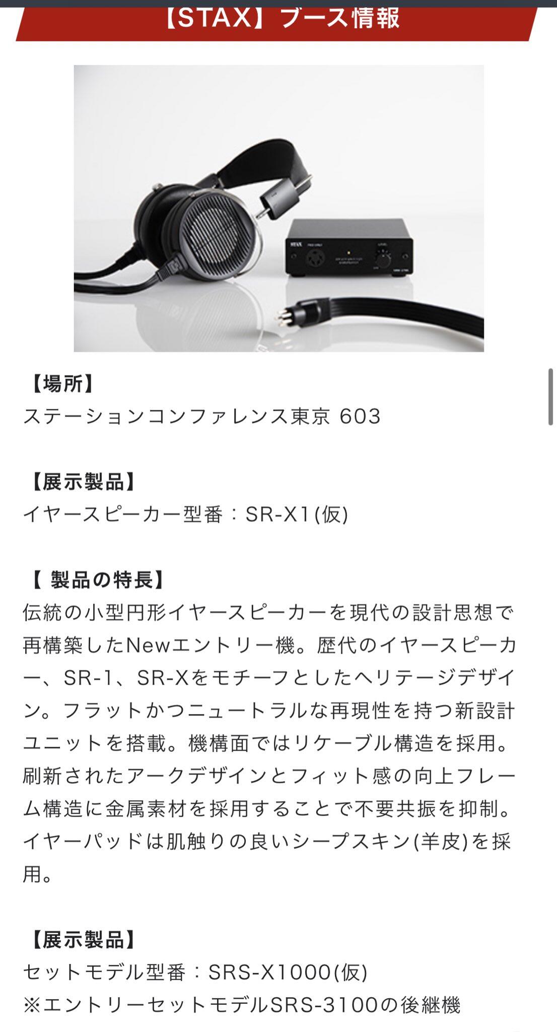

I'm very curious about the driver construction though. Are they actually going to make it like the original SR-X with a mesh stator? Quite looking forward to seeing more info on them coming out. Anyway I actually think it's a good decision for Stax, the L300 is... not good and Stax does have a neutral/pro headphone hole without the 207 anymore

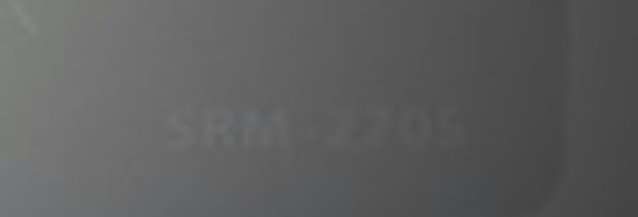

The SRM-2705 I think is the big clue since its probably a SRM-2xx. Why call it the 2705 though and not a 270S? Unless that 5 is an S but it looks too different

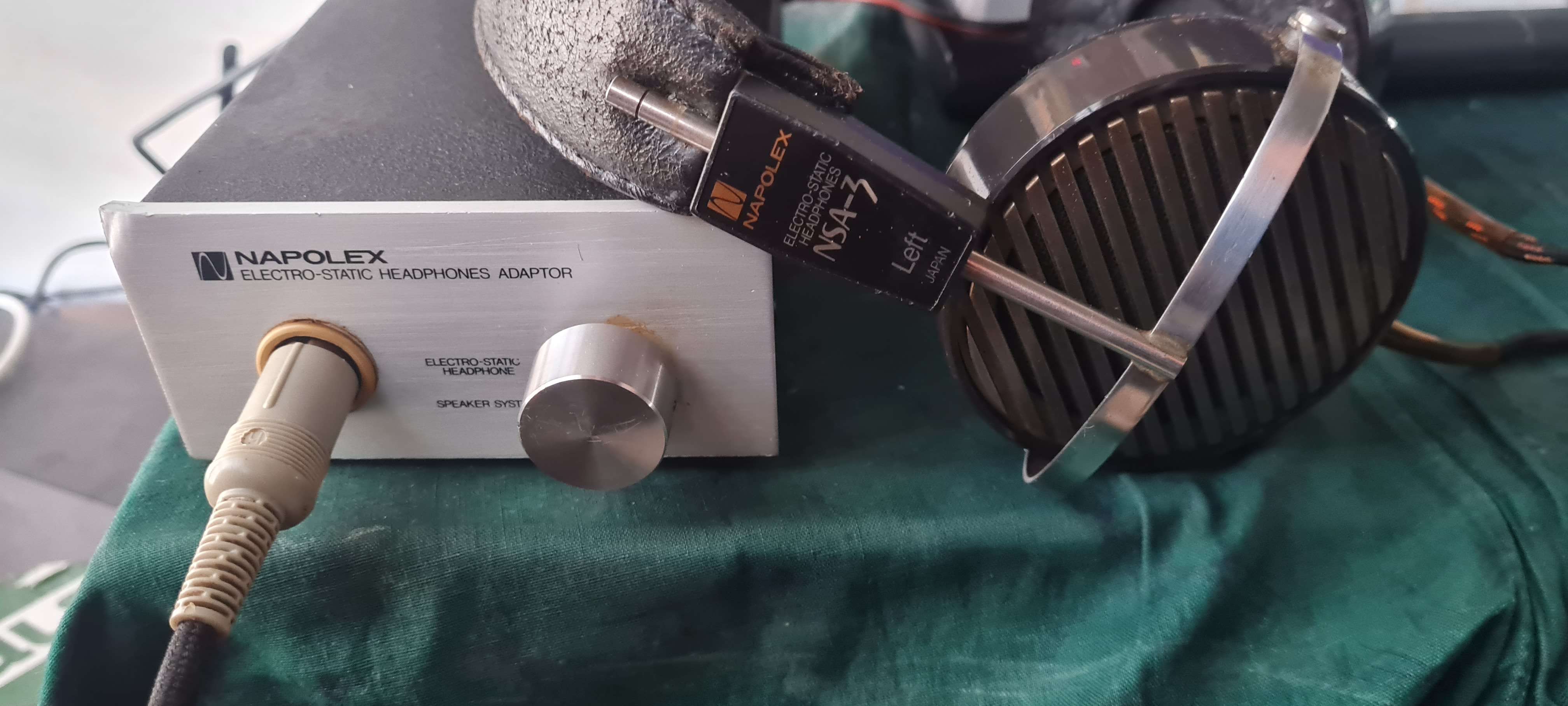

Sorry for reviving the thread but don't know anywhere else in the site I can post this, got something curious. A Napolex NSA-3

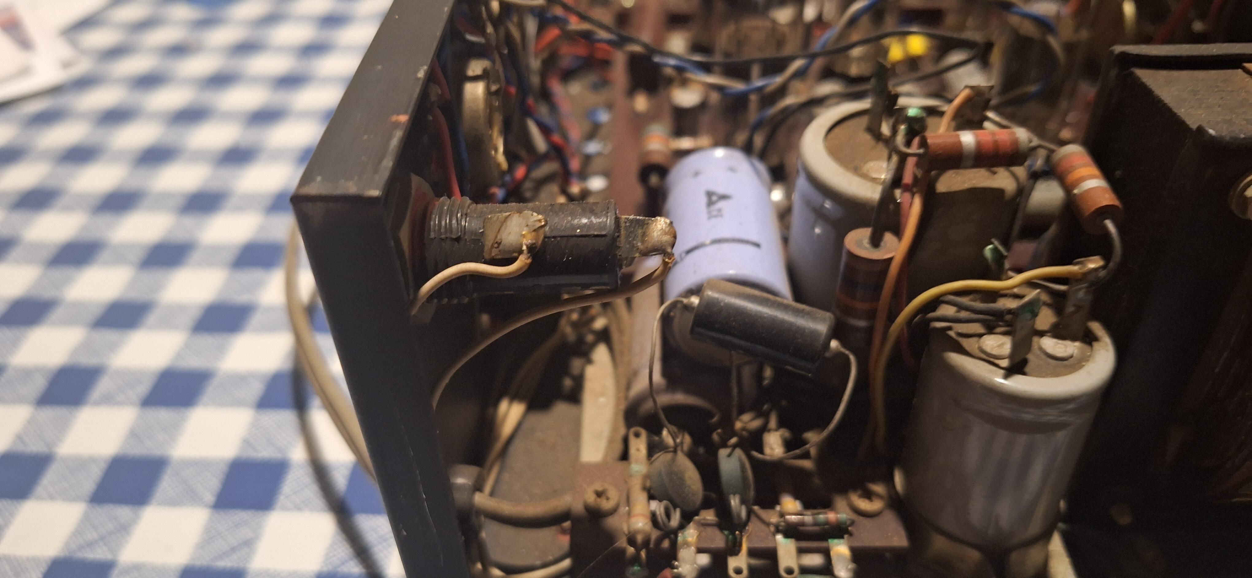

Repair and restoration of my STAX SRA-12S
Bingturong replied to Quad's topic in Headphone Amplification
Another longtime update. Going through the amp I found that pins 7 and 8 on the phono connector were already jumped. After more thinking and pounding my head, I realised that the ground for the for EVERYTHING but the power/bias section is actually coming out of the phono board connector. In the schematic the ground for PB-300, PB-200 and PB-100 were all connected together with the ground wire coming out of the PB-100 board. For some reason PB-500 ground was connected that of PB-200 instead of PB-100 but anyway. I just rewired so the ground connection is at the PB-200 connector instead leaving the PB-300 connector essentially unwired except for the MAG input. The amp is now working flawlessly and is silent than ever! -
I've been pulling my hair with the damn phono board to the point I might as well rebuild the entire thing leaving only the film caps. Is there anyway to bypass the phono board in the amp? Without the phono board there's considerable hum. -
A strange update, so rectifier and a few other diodes replaced and yeap! That strange warbling sound is gone. Except now there's a significant amount of distortion on all channels. After trying some stuff, removing the PB100 board seems to solve it. Since reading the schematic, I assume that the PB-100 is not exactly necessary is it? Since it only does the mag pu? -
Right so apparently I didn't read enough. I found an old post by spritzer that said it worked find with his C-series SRM-1 Mk2 and meant for amps that didn't come with a jumper. Though mine isn't a c-series it didn't ship with a jumper but heck it should work. Tried it out and it powers on, no explosions, no burning, nothing. Plugged in a headphones AND there is still not audio. Though I have discovered that the normal bias does not energise at all whereelse the pro bias does, there's also a hissing sound too only from the pro bias. A quick voltage test from the rails show mid to upper 360V so it seems the voltage change has been a success. Given that the caps I used are rated at 400V, I think I may go find some new ones... My biggest worry though is the transformer is a goner so I'll test that out.
