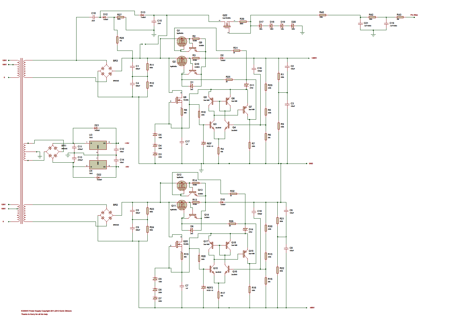

  1. Thanks to all. I think this is the psu?

  6. Kevin, what are the advantages of the srx input stage? How do you calculate gain and input/output impedance? Will two ccs in place of R1 and R6 make possible to avoid the global feedback?
  7. I've to say the out stage does looks to me a lot like a "paralled" srrp...
  8. ... or you are referring to the tail side only being ccsed? Sorry for the obviously dummy questions. Thanks.
  9. Thanks Kevin. The first stage is interesting indeed. I've never seen such a ccs (that doesn't want to make a statement of any sort of course). How the CCS works? Is its connection crossed between phases to balance the two outputs? Thanks.
  10. ... now my ears are sticking out:-) Electronics Schematics are still my favorite. Will yo be willing to publish those? are we talking about close to 1kv ptp output with 2 V input signal? Thanks.
