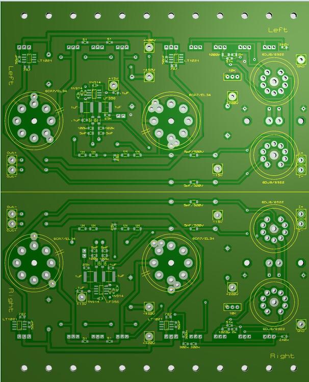

  19. I’ve got questions about using +/-450V supplies with mini T2. It would probably work alright, I can’t see why it wouldn’t. If using a drop down resistor for +220V there is a Vishay 24.9k/3W that probably will do (haven’t tested it - maybe I should or someone else). One other request is the location of stand of holes. Attached are templates for left and right boards - imperial and metric. I had to print them 100.4% to get scale 1:1. They don’t look nice but that is what I managed to do in Proteus. holes mini T2 Right v.23.PDF holes mini T2 Left v.23.PDF mm holes mini T2 Right v.23.PDF mm holes mini T2 Left v.23.PDF

  21. mini T2 v.23. Changes from v.22 Ground plane at area for brackets removed. Silk screen lines 20mm from long side edges, cut here if you want transistors mounted direct on heat sinks. Then you also have to run wires for +B traces just been cut. Be careful you are now close to other traces - only for DIYers. Regarding wishes for tblocks I want to quote myself (from a private conversation oct. 2018) “I haven’t used them at all with amplifiers and I have never missed them. Advantages are: - you can route the wire to the spot where it’s wanted, – the connection is much safer than with tblock, - saves space, – with a desolder gun or a solder iron they are easy and fast to “disconnect”. This also what Kevin did with his DIY T2 except for the outputs to earphone. With power supplies I use tblocks, then I find them convenient. Bottom line - IMO – tblocks destroys a layout.”
