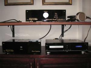

  1. Some infomation about my build. Powered up the psu just now. Voltages were sitting as per spec. both at the +ve and -ve 500vdc and 15vdc. Then power up the amps. Balancing was perfect. However, I was not able to get the dc offset down to 0v Max I got was about +60vdc and was out of turns. Kevin suggested to either decrease the value of R26 or increase the value of R12 and R19, citing that the IXYS part was pulling too much current and is out of spec. Can't understand why the IXYS which is from mouser would do that. Anyway, Kevin said to change R26 from 2k to 1.5k. Didn't have that in hand so used a 1.2k. Hurray! Was able to balance and get the DC offset to roughly zero. What fuse rating would be good for this amp? The KGSShv pulls 5.5ma x 4. http://www.head-fi.org/t/582518/electrostatic-amplifiers-voltage-ratings
