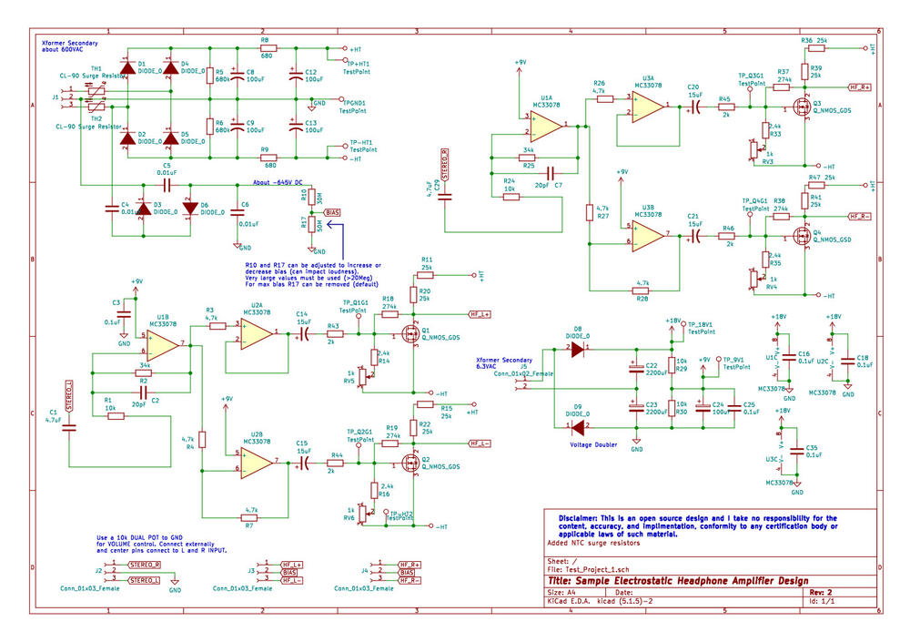

  3. Since there's many people here far more intelligent than I, can't hurt to ask. With the fixes suggested (flip bias polarity, ensure 580v, add 5.1K resistors), would this be any sort of improvement over the SRM-252S? I'm running an SR 407 which is a nice set but nothing fancy. I'm trying to experiment with more mid-range electrostatic gear so when I inevitably get something higher-end later I'll appreciate it more. The total cost of this build is about $300 FWIW.

  7. Thanks for the feedback gentlemen. I think if any little quirks can be ironed out this could be a low-cost, accessible offering for entry-level electrostat DIY. The bias supply is indeed negative. Forgive my ignorance but what would happen to the diaphragms if negative voltage is used? I was searching Google and digging through old posts but couldn't find a definitive answer. Would the 5.1k series resistors go between the positive outputs (L+, R+) and the headphones?

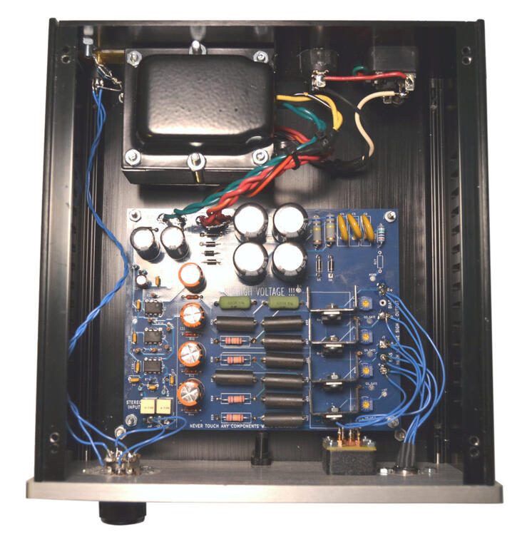

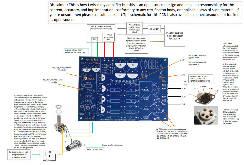

  9. Nectar Sound, purveyor of the Pollinator and now the Hive headphones, has a DIY amp published on the website. I reached out and picked up a PCB so I can build this low cost energizer and see how it stacks up against my SRM-252S. Attached is the schematic, BOM, image of a completed amp, and hook-up guide. You can also access everything on the Nectar Sound website. Sajeev has updated the board slightly from the images attached to hold a pair of CL-90 inrush limiters to prevent blowing a fuse on start-up. I'm in the process of gathering the parts now, but wanted to post this to archive the build and see if anyone else was building (or has built) one. Nectar1p0_HeadphoneAmp_Rev2_BOM (1).xlsx
