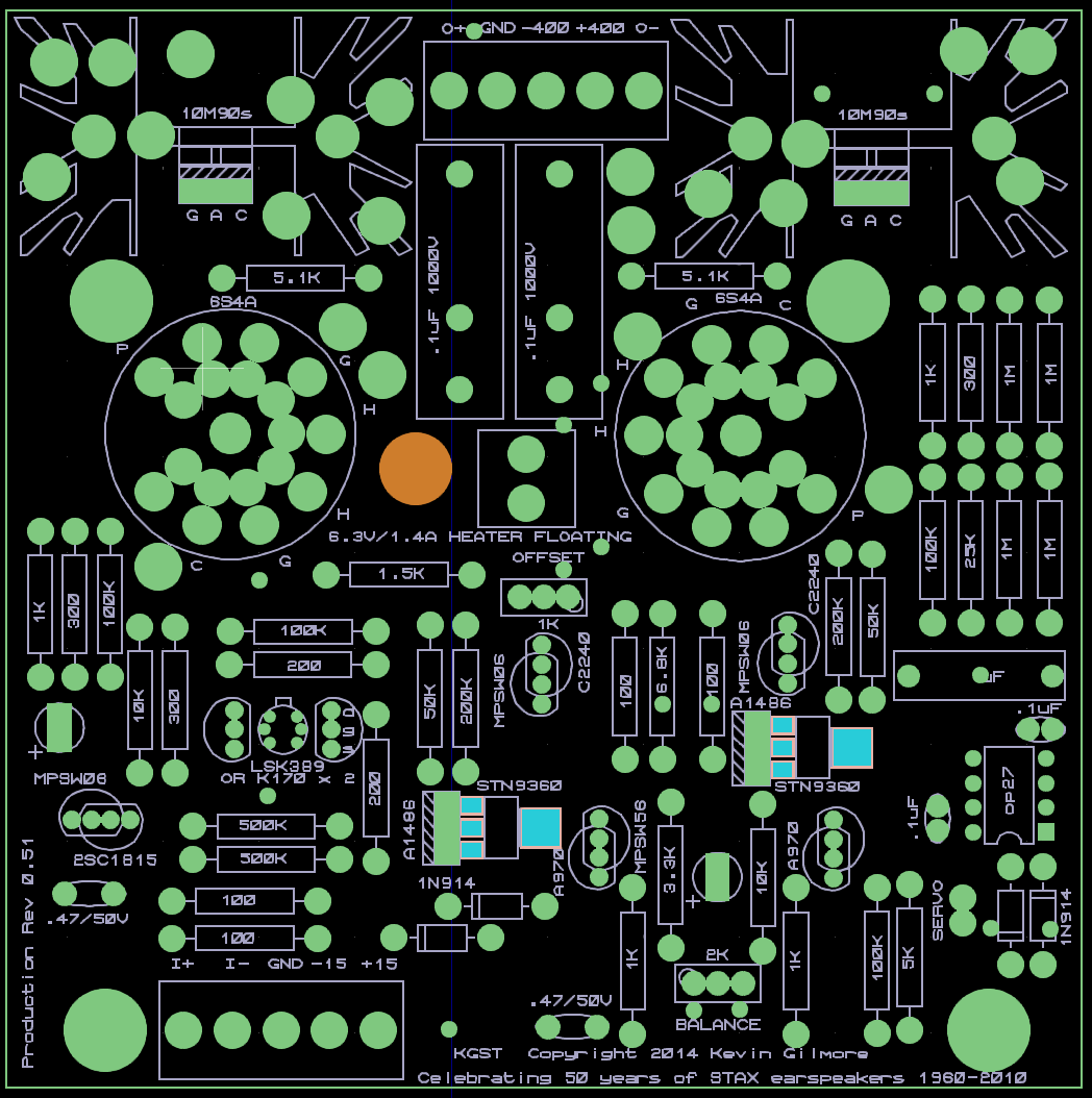

The layout referred to this(kgst-miniv05). Didn`t find the DN2540 in this version. DN2540 version added to the previous post. Q1 (MPSA/W06) can be replaced by 2SC3324. Q4 and Q6 (MPSW/A56) can be replaced by HN4A51. Q5 and Q7 (MPSA/W06) can be replaced by HN4C51.

you forgot the dn2540 cascode on the 10m90s

updated board file, 10k input resistors added (optional) and 25k changed to 17k cfaelectrostatschem2-4 - CADCAM.ZIP -
Time really flies — it's been over 10 years since the KGST first came out. KGST was one of the very first DIY electrostatic amps I ever built, and it's still one of my favorites today. Recently, I noticed that the schematic in the Stax Mafia Google Drive has diverged quite a bit from the latest version of the KGST PCB layout. So, I decided to take this opportunity to redraw the schematic based on the newest KGST layout. Hopefully, this will be useful to anyone who needs a fresh reference. Please double-check the schematic before using it — there might still be mistakes. Component numbers follow the original KGST schematic as much as possible. New parts are numbered sequentially. Changes from the old schematic are marked in red The servo section has been added Obsolete parts like C2240//A1486/2SC1815 have been replaced with currently available ones Attached below is the schematic. Next step: I'm planning to attempt a shrunk-down version of the KGST layout, inspired by @JoaMat great work. KGST_2025.pdf KGST_DN2540_2025.pdf

I like the idea about to-252. First draft… …have to think about this. XLR ground pin to signal ground on PCB.
Didn't take pics, but cooked bacon, hashbrowns and pancakes on the new griddle. Dorothy cooked scrambled eggs inside. Worked fantastic! My assistant griddler (DOTU)) and I made quick work of it, and had fun.
IXTP10M90S can be replaced with IXCP10M90S(TO-252). If KSC2690 can be replaced by something else with an SMD package, we can eliminate all the aluminum oxide isolations. BTW, what is your grounding strategy? Seems like the ground pins of the XLR input go back to the PSU enclosure.
